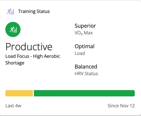

Almost fully green- What should I do to stay "productive?"
I'm almost there.  Productive for a full 4 weeks.  this is the holy grail of garmin training.
But- you never know when Garmin will switch to "maintaining" ... or worse.  I'm in the middle of a marathon training program, and it's been going well.
What do I need to do to stay "productive?". It says I'm low on "high aerobic" and I have an 18 w/ 12@MP this weekend, which should fill that gap, but no high aerobic runs before then.

  • Thanks.  All good general training advice.  I am a coach.  I’m working through a marathon plan right now.
    But I was kinda’ looking for how to ‘game’ the garmin system for assigning “productive” and “unproductive” or “maintaining” training status levels.  Like- am I just one wrong workout away from “maintaining”?  How would I know?

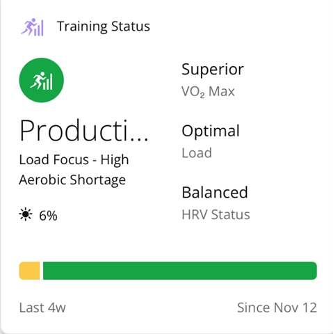

  • Getting close- will I make it?  Got in that 16 with 12 at MP today.

  • I was sooo sooo close.  Maybe I can do another workout today to turn it green?  or is that it for today?

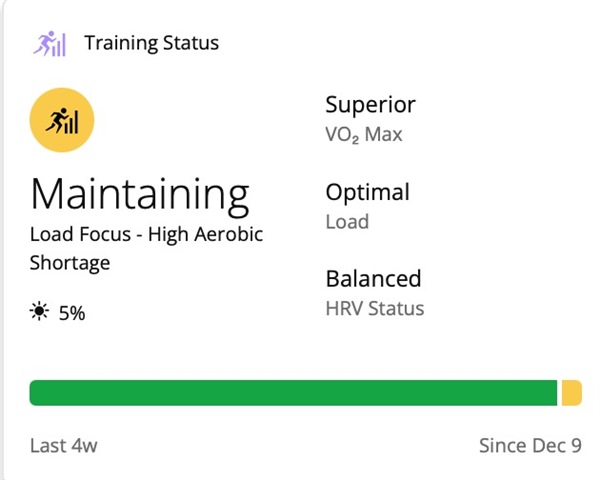

  • I'll try to ignore your judgmental comment implying that you don't approve me me doing a less than optimal training program just to get a green bar.  this is just for fun, and fwiw I haven't from my training plan so far.  It's been going well, and I just finished a 3 week build which included my first 20miler of the cycle and then just this past weekend, a 16w12@MP.  So far, feeling pretty good and my training has gone really well.  and yet today, I wake up to "maintaining"- when I just finished my biggest week's so far?  dunno why.  Today is a rest day.  I did an hour of strength this morning, and my "maintaining" status didn't change.  I"m going to try a little on the bike to see if that makes a difference.
