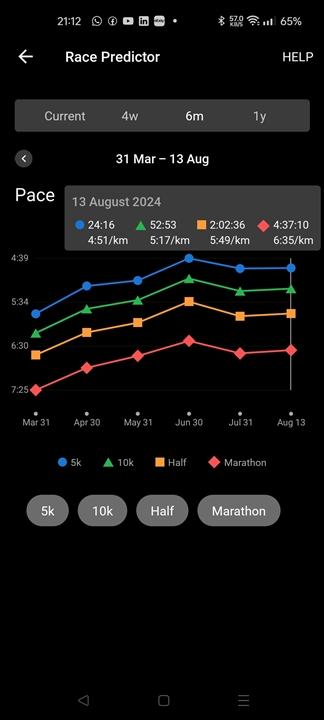

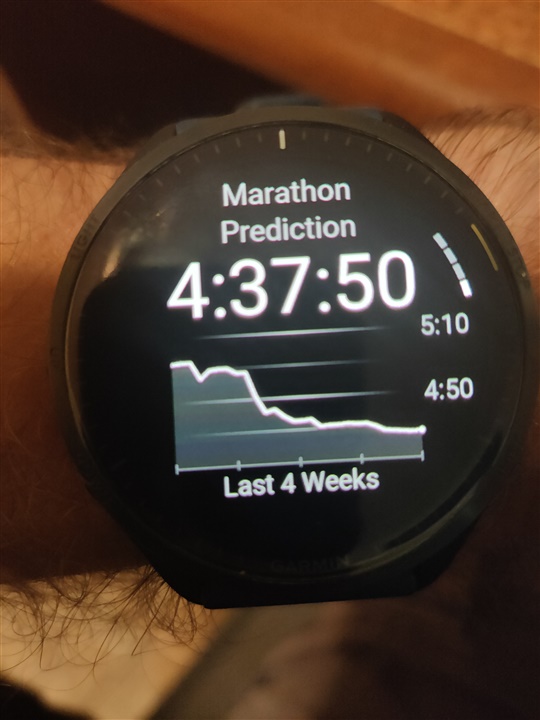

So when I look at my race predictions in the fr965 or Garmin Connect I see different numbers for the marathon prediction in different places:
On the watch: 4:37:50
In Garmin Connect (android) - in the Current tab: 4:37:50

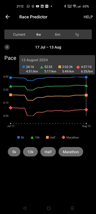

In Garmin Connect (android) - in the 4w tab: 4:37:10
In Garmin Connect (android) - in the 6m tab: 4:37:10
In Garmin Connect (android) - in the 1y tab: 4:37:10
(In the 4w, 6m, 1y tab you have to touch the graph and move your finger to the last column, then you'll see the prediction for today)
For the other distances all these screens do agree, but not for the marathon.
