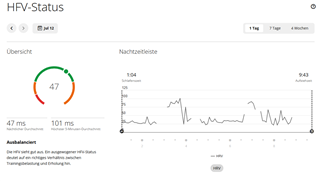

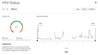

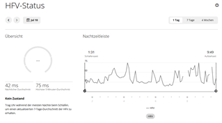

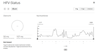

I want Garmin to check the HRV Gaps problem and if there is any corelation with this:
I didnt wear the watch for sleeping for  a while, so that the HRV Status was not availible.
If HRV Status was not avalible and i wore it during sleep, my HRV Gaps were gone  and the Measurement is, how it supposed to be, until my HRV Status appeard again.
See Pictures.
I was sleeping the same all the Nights with watch on the same arm.
Garmin, Could you please check if the Bug is afected by this Problem ?
