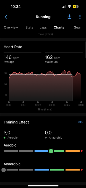

my max heart rate was updated even it doesnt reached max zone
Hi, why my max hr was updated to 192,( previuosly was 191), even it doesnt reached >170 during my run? Im using also garmin hrm pro plus strap

  • because the "Auto Max HR detection" is enabled, and this feature is trying to guess your max hr from the HRV data and its FirstBeat data library. the funny thing that when my measured maxHR was 182 during the activity, it gave me 181 as predicted maxHR (after many wrong predictions, i turned off as i turned off the FTP detection also, that is also low in my case)
