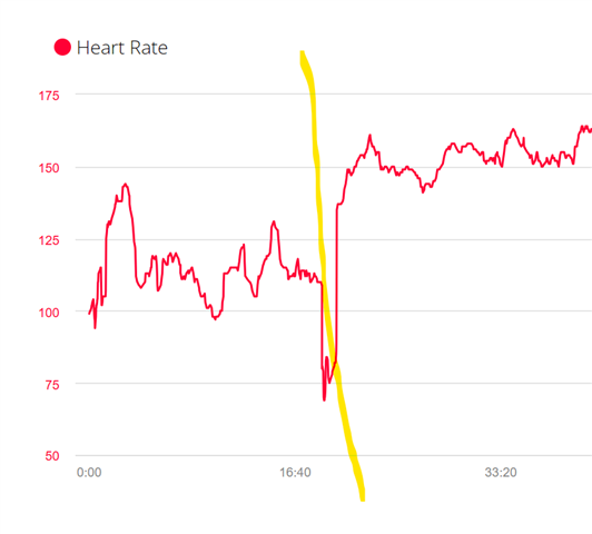

  • If can be of any help for firmware developer to solve the bug, for me the problem occurr at the begin of a run and tan all goes back to normal. I don't wear the watch at night so I don't know if this is the issue or if the other wear or not.
    Probably not wearing the watch at night with last releases maybe the sensor loose precision and it takes time to calculate correctly once you start an activity

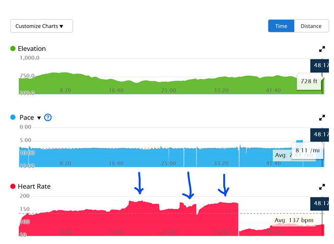

  • Incredible stuff, I have a Fenix 7 standard  running 16.11 and I have also noticed that my watch hr suddenly drops to 45bpm whilst on a run. I had to restart the watch to get a clean reading.
