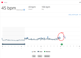

  • So, an hour ago I took the watch off while registering a short indoor ride on my 1030+, but then got gaps in daily heart rate diagram. Can you confirm that is not the case for you using a 1040?
  • Here an example for Monday:
    I had a similar problem like you had. I guess you are using Garmin HRM strap? Please do the following after a ride, open the Garmin Connect Mobile app and keep the HRM strap on, this must be synced also. In my case I could see that the HRM strap was not correctly registered. It helped to remove the HRM strap from the app and register it again. After that I always see my strap as connected and I have no gaps. The small gap here in my day is the shower ;)
  • Ok thanks, but using an old HRM dual (?) for indoor rides, so no cache on that one.
