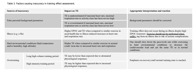

    This is a sign that your HR Max is wrong, and too high. I suggest you drop your HR Max by 10bpm and see if that helps with the wrong assessment.
    Microsoft Word - EPOC_based_training_effect_assesment_REVISED 2.doc (firstbeat.com)
