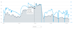

Hello,
i did a guidded lactate threshold test and in my opinion the results cannot be true.
test says: HR 162 Pace 4:29 /km
from the HR and Pace charts i cannot see that i reached 4:29/km with a 162 bpm. Not even close. With 162 bpm i was at 5:20 /km region.
Do you think there is some settings to adjust ?
My Max HR is correct at 187 bpm.
  • I want to have that LT Pace correct for my daily suggested workouts

    And yes my DSW are way too fast. thats why i use HR target all the time.
    i cannot run 20 min at 4:30 pace for my threshold run at all. Base and VO2 max runs are also waaay off.

  • Hey, i checked it and no my Pace comes directly from the watch.
    i didnt run on treadsmills with it, but maybe in winter i will.
    And my HR Max is not off, bc i did it on a field test, just like described from the brand Polar.
    i am really annoyed with the metrics, bc i hoped that garmin is accurate in this regard :/
    Bc it motivates to see how much my LT improves over time, but if i know its way off then its garbage.
