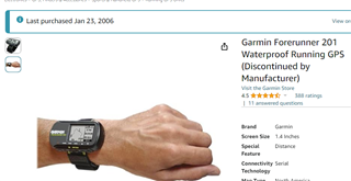

    I go waaaay back with Gramin, the FR 201 -- that was lovingly referred to as "the brick" .. took an eternity to lock into the GPS signal.
  • Yes I had that as well, 201, 305, etc
