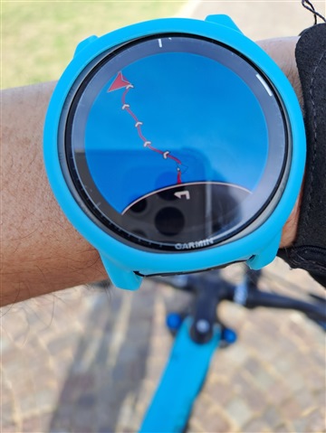

  • Tried the 965 course navigation on a 50K bike ride, on my left wrist. On my right wrist my old 645.
    The 965 is going back. Slower off/on course than my 645, turn alert same thing, and vibration softer too, sometimes I missed it.
    Gestures sucks, at least on a bike ride.
    3 hours ride, HR and Speed sensor connected, all out GPS, nothing else. Clear sky and I was riding by the coast. 25% battery drain by just looking at the map when I needed.
    Visibility is good in a sunny day with sunglasses, never had problems. However, everything looks smaller on the 965, due to the higher resolution, so I prefer the 645, easier to read, bigger arrows and such.
    Finally, at some point the 965 thought I was Moses cycling on the sea. That was funny, but also last nail in the coffin...
    Here is a photo. Ignore the case and screen protector, they are for another watch, I was just afraid of scratching the 965.
