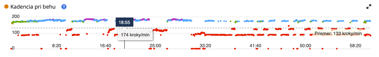

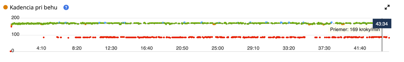

Hi to everyone, in my recent runs, I noticed that my watch calculates cadence incorrectly. This happens with both the latest firmware and the previous one. Almost half of the run is recorded with only half of the actual cadence, which can be seen as red dots in the cadence graph.  The watch is worn tightly on my wrist.

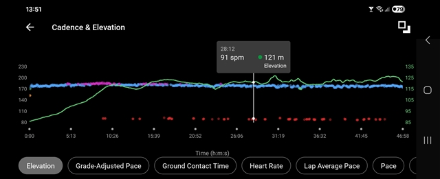

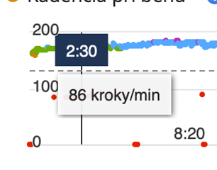

I noticed this during my last runs by chance when I looked at the watch — at that moment, the display showed only half of the cadence value, for example 87. When I slightly raised my arm while running and looked at the watch for about 5 seconds, the number suddenly jumped to around 175. This happened several times during the run.
I am attaching screenshots from the last two runs.
FR 955 Solar with latest 27.09 fw.
This is today’s run. The initial gaps are walking during the intervals. However, the issue can also be noticed at the beginning and at the end of the run.
Thanks for any advice.
Martin
  • I will keep updating this thread until someone from Garmin notices it...
    This was my run on Friday. Whenever my arm is in a normal running position, the cadence values are incorrect — those are the red dots. Whenever I rotate my wrist and look at the watch, the cadence is calculated correctly. On my other wrist I was wearing an Apple Watch 6, which measured cadence without any issues. Garmin, please do something about this.
  • Whenever I rotate my wrist and look at the watch, the cadence is calculated correctly.
    My experience with this bug is that it is more of a randomised timebased such than depending on wrist position. Though, your experience could surely be evidence of another variant of the bug. However, the whole bug-concept is far, far from a new one. My FR955 (non-solar) still is at FW 19.18 and looking at a random Run session from the summer of 2025 (last time I regularly used the watch), the below screenshot paints a typical picture. Observe that the watch is 'clean', i.e. not attached to any external sensors, HR, Stryd or others:
    I believe the cadence 'half-life' bug stems from the very beginning of Garmin exercise watches, when cadence indeed was expressed as in cycling - that is, by a RPM value (Revolutions per minute). Later on Garmin did an 'easy' adjustment in the algorithms and doubled the value to keep up with a more modern sense of running cadence. But... bugs happened and now probably is so deeply entrenched that they've given up on finding/fixing them.

    One thing I can see in the FR955 graphs is that the inbuilt GCT etc also show bad data points in tandem with the Cadence halving.

  • One thing I can see in the FR955 graphs is that the inbuilt GCT etc also show bad data points in tandem with the Cadence halving.
    Hmm maybe something else is going on then? (Besides the "normal" half cadence bug that people have complained about for years. Or maybe this *is* the normal half cadence bug?)
