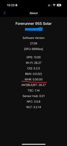

After updating my Forerunner 955 Solar to software version 27.09, I’m seeing what looks like a firmware issue with the wrist heart rate sensor (WHR).
In About → Software Versions, WHR now shows:
WHR: 0.00.00
Before the update, this value was not zero. Since updating:
  • Wrist heart rate does not work
  • No HR data is recorded during activities
  • Rebooting the watch did not fix the issue
Additionally, every time I put the watch on the charger, it starts “installing an update” again, but it is always the same version (27.09).
The update process completes, but the problem remains and WHR stays at 0.00.00.
Other firmware components (GPS, BLE, CIQ, etc.) show normal version numbers.
I’ve attached a screenshot from Garmin Connect → Device → About showing the issue.

This looks like the WHR firmware may not have been flashed correctly during the 27.09 update, and the device may be repeatedly trying (and failing) to apply the same update while charging.

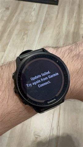

  • I tried reinstallaction again, and noticed that it says Update failed.
    That says it's definitely firmware update issue, support is ignoring me, it's sad.
