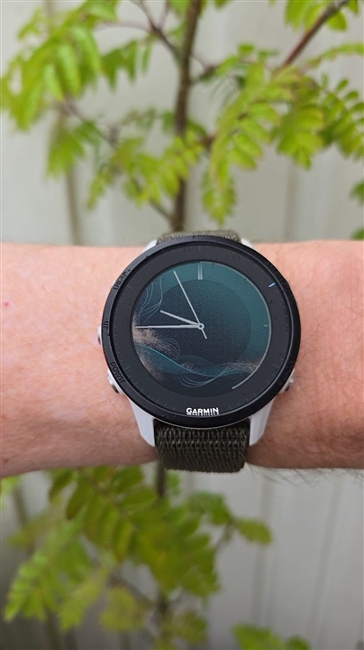

    Not only sideloads it seems... The watch face pictured below is called "Elegance" and was created by Garmin themselves, but then later removed from the Connect IQ Store. The Connect IQ App can not see or manage it, though "My Watch Faces" lists it as one extra 'Ghost' Face. The on-device Connect IQ store app, as you informed us, can see and delete it (but have not tried a deletion ;-)
