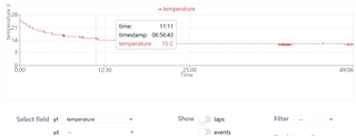

It's because altimeter is influenced from temperature. Here it's winter and when I start a run the altimeter immedeately jumps 50m above actual…
A quick comparison. On the top a run during summer, on the bottom a run in winter. Same roads, it's a round-track I use for 90% of my trainings, you can see between red lines a single "lap" of 2250m.…

It's because altimeter is influenced from temperature. Here it's winter and when I start a run the altimeter immedeately jumps 50m above actual altitude and then, when the watch cools down, comes to normal altitude. During summer this problem almost disappears. My wife with 965 doesn't have this problem and her altitude is perfect.
Garmin has to improve (or develop?!) the algorithm to correct the influence of temperature to altitude
The start of both trainings is at 208m, calibrated each time just few seconds before starting the run. You can see that in winter, even after the calibration, at the start the altitude immediately jumps higher of about 30m and it continues to go higher to 252m!!! Even the summer graph is quite inaccurate as you can see...
Real altitudes are about 206m for minimum and 210m for maximum
