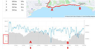

    Here are some examples from my activities wearing the watch always on the left wrist on different activities crossing the same endpoint.
    Coast run
    Seems pretty flat 3m difference between starting and end. Some change might also be due to having not exactly the same ending point.

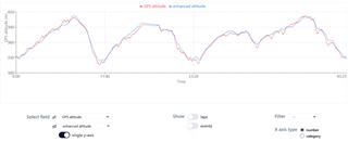

    Via ferrata
    You can see a drift here at the summit of about 10m which I end about higher than starting.
    Very windy day especially in the wall you can see at the wiggling graph on the ascend.

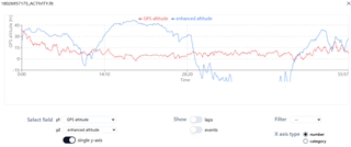

    Trail run
    Starting end ending point at the same height (1m difference)
    So in my case I can say the altimeter works better than I ever expected and deviations, if there, are small and reasonable.
