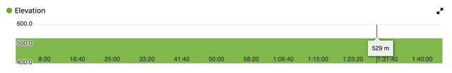

Hi everyone, I've run into a problem with my Garmin Forerunner 955 after updating to firmware 20.26. Yesterday, during a race in hilly terrain, the altimeter got stuck at a single value:

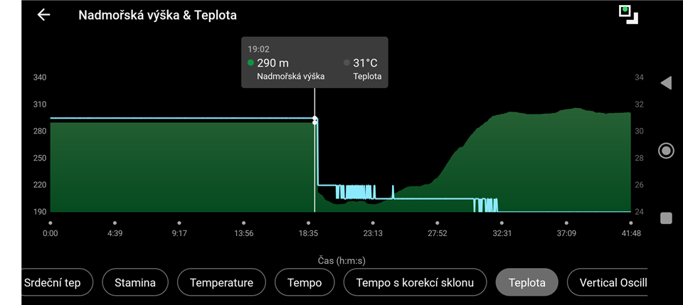

The issue was also visible in the altimeter widget. While it was measuring normally before and after the activity, during the race (where other runners' watches measured about 150m of elevation gain), mine showed a flat line.
I ran the race using the Run profile with PacePro enabled, but navigation turned off.

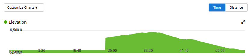

This seems like a newly introduced bug, as I run often and this is a first time I have seen it, right after updating to 20.26.
