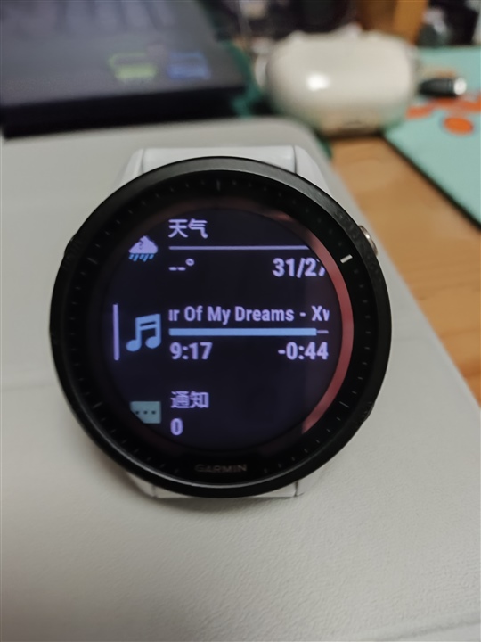

As title says, the duration of music is shown incorrect on my fr955 solar, which is longer than the actual file. This situation only happens if i imported mp3 files with their bitrate lower than 320kbps. If the bitrate is 320 kbps, the length of that file is reported correctly.
firmware version 19.18
See picture for example:

  • I think this is a legit bug and you should report it to Garmin ([email protected] or https://support.garmin.com/)
    However, most ppl probably use Spotify rather than importing MP3s, which might explain the lack of responses to this thread. I happen to do both, since I download some stuff from youtube (and other sources) that isn't available on Spotify, but I feel like I'm in a tiny minority. Having said that, I haven't seen the length problem, even with MP3s with a lower bitrate than 320.

  • thanks for reminding, already reported
