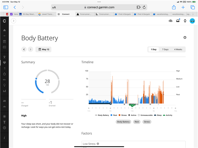

We have had two 955s for over two years - I wear mine 98 percent of the time (except for charging). My wife wears her 955 about 60% of the time.
My wife’s watch displays her Body Battery statistics in connect.garmin.com on her iPad and in the Garmin Connect app on her phone.

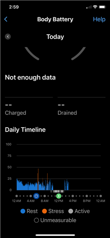

My body battery stats have never been displayed.  I get a message “Not enough data”.
Have I turned something off that is keeping the Body Battery stats from being collected by the 955 and displayed by the apps?  Suggestions?

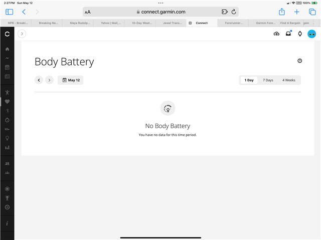

  • Here’s what the metric looks like at connect.garmin.com.
  • My watch does collect sleep, HVR, and activities.  I’m stumped.
