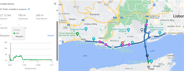

    I have another problem with PacePro and Course.
    My last running Half Marathon started on the bridge.
    As you can see Course elevation is not on the bridge but on the water.
    You can imagine what PacePro plan looks at the begin, but luckily you can Edit Splits manually and correct this.
