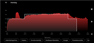

Is this my heart going mad, the watch or the strap :-)
FR955 Solar
Garmin HRM-DUAL
Training Treshold 10min z2, 25min z4, 5min z2, cooldown
In the first section z2, after about 5 minutes, my HR goes up from 150 to 180bpm, stays there for 90 seconds and slowly decreases to the right level of 150 again. No tempo change there, no sudden wind shift, no hill.
Weird isn't it?
  • Very weird.
    Two things came to my mind:
    1. Battery of the hrm-dual is dying.
    2. You had a connection drop and this HR peak was from the OHR.
    There are some tools you can use to analyze the .fit file to check if you find something weird on the data. I don’t remember the name but someone here probably will help with that.
