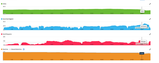

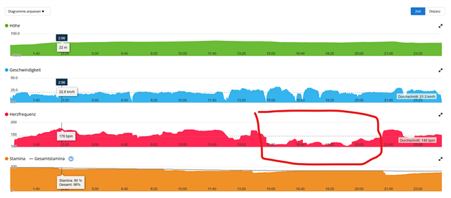

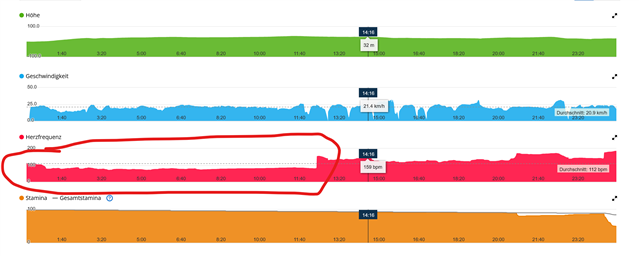

Now it happened 3 times. My FR955 somehow showed much lower heart rate at the beginning of the bike ride. Each time I took the watch off the wrist, waited until the HR zeroed, put it back and it locked the HR immediately. Is there a cure for it?

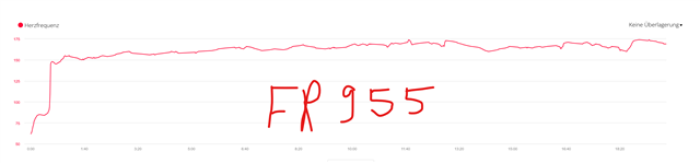

An example of the ride when Garmin did not record the HR properly in the first half an hour. Then I took the watch off the wrist, put it back after a minute and it locked to the right one. The first 30…

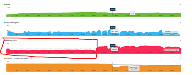

Exact same issue running. Starts low and remains low and then jumps to the actual heart rate 10-20 mins in. Hasn't always been the case. I'm thinking it started with the 18.22 update.
