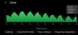

  • I'm wondering because I never noticed this kind of issues. I also often had this warm-cold transistions because I use the watch for cross country sking. If it gets at some point cold again here I will be aware if it happens at some point and if there is a way to reproduce is.
    I also rechecked my cross contry activities and is have deltas between 1 to 10 vertical meters on back on the starting / return point with total vertical meters of about 350m.
    But this seems normal to me taking into account that ambient pressure can easily change 1hPa within one hour, resulting into a elevation difference of about 10 meters.
    So in my opinion it should be possible to export the raw readings of the barometer so you can check the readings before the calculation and algorithm magic starts. So you could check better if the barometer works properly and if this is ok, the issue is probably software related. Because regarding the graph miky posted it could just be, that the ambient pressure dropped during his workout.
