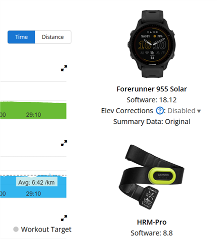

Stupid question: But where can I find the battery status of my HRM-Sensor (Garmin) in Connect App exactly? Haven't found it yet after a while searching in activity details, ... Thank you!
