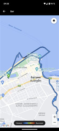

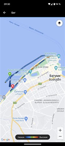

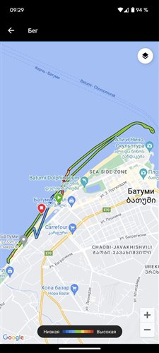

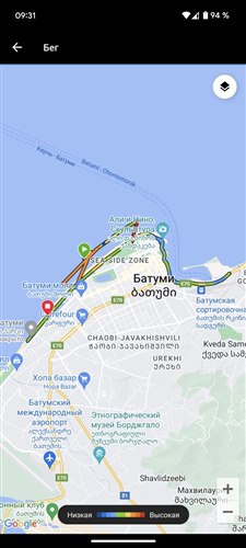

Hello everyone, there was a problem with the GPS on the Garmin Forerunner 955. When I came on vacation to Batumi (Georgia), the GPS reception was poor. I have done several runs and always have the same problem, the first 10 minutes the pace jumps a lot, then it returns to normal. This happened for 4 training sessions. I tried different satellite settings, even did a factory reset, but nothing helped. When I ran with the other guys, everything was fine with them. Please tell me what could be the problem. I am attaching screenshots from the training sessions.
  • It's known that the Black Sea area has seen some GPS jamming over the past year, and your tracks suggest there was interference when you were on the northwest facing coast (sea side zone), with a good track when you were sheltered by the headland near the harbour.

    I know others have downvoted me for saying this, but this sounds very much like external interference.
