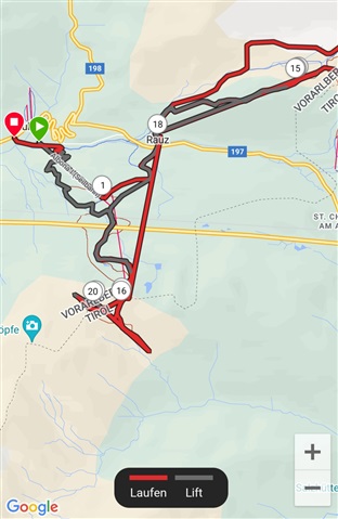

Hi there, at the beginning of the ski season I have discovered that the watch did not track my ski runs. Stayed on a something like pause mode(yellow circled screen).
Last season it used to be working with just start of the activity and when I stop it in the end of the day it used to be showing everything, now barely track only one ski run for the day. Happened two days in a row, tried with lap button, but second day no runs at all. Auto run is set ON
