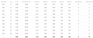

On a run with short intervals, I've noticed that the average GAP is slower than expected.
In the five 30 s intervals shown here:
  • three have (nett) ascent, but two of those have slower GAPs, and it's only the largest ascent that shows a faster GAP, as should be expected for all three;
  • one has no ascent or descent, but has a slower GAP; and
  • one has nett descent, and has a slower GAP, as should be expected.
Time Distance Avg Pace Avg GAP Total Ascent Total Descent
00:30 0.12 04:06 04:17 1 0
00:30 0.11 04:27 04:32 3 0
00:30 0.12 04:01 04:36 0 2
00:30 0.12 04:01 04:16 0 0
00:30 0.11 04:44 04:26 5 0

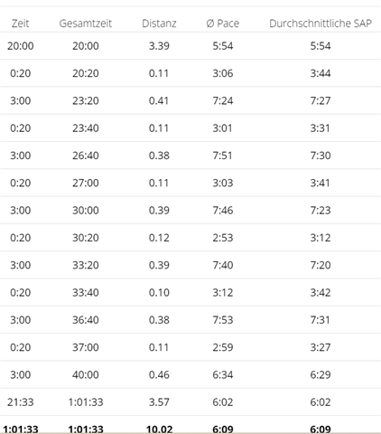

    On all my runs on flat grounds, the av GAP is almost identical to the the av pace. Here is an exemple where I run continuously, on flat grounds, at an easy pace

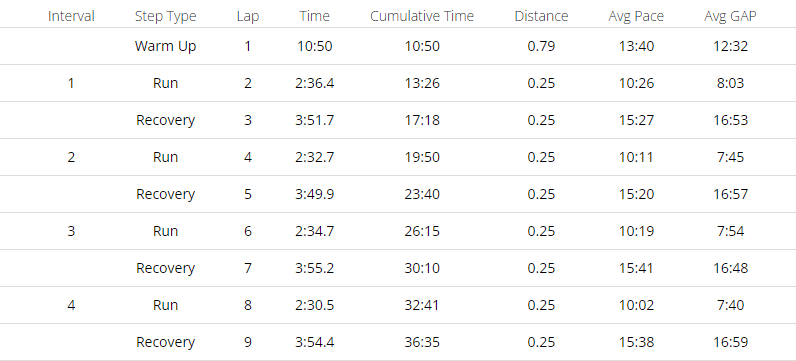

    Not in my experience. Here are some hill intervals. I was running based on power in the upper limit of my zone 4, lower zone 5. My RPE was maximal effort. I was walking/jogging down leisurely.
    As you can see the up hill sections have a lower value for GAP than for pace. In addition, the GAP is a bit slower than my threshold pace. I wish it would be a tad faster since I was in the higher threshold zone/VO2 Max zone. So it might not be strictly equivalent to a flat pace.

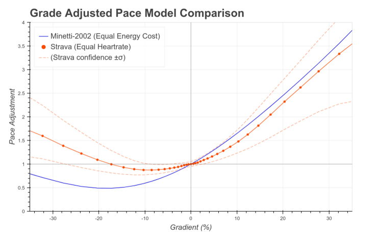

    So, then, how do we rationalize your observations? As I said earlier, the main issue with your test is that your intervals are too short. This makes the data prone to altimeter/pace distortions. Strave uses 30s intervals for the calculation. Garmin doesn't say. However, their patent on VO2 Max calculation and heart rate data segment qualification mentions short intervals of 20/40s. So it is possible that an HR value of X with pace Y on the watch is really the most qualified 20 to 40s average HR value of X with pace Y. This is important because the GAP adjustments are assymetrical on climbs and downhills. This means you "slow down" more uphill than you "accelerate" downhill.
    Finally, remember this is a model. It has an error rate. As you can see in the strava model, for a gradient of 10% (decent climb) Strave will adjust your pace by a factor of x1.5, but you have a 68% chance for it to be between x1.7 and x1.2

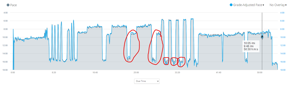

    One thing to try is to display GAP and pace on the same screen/graph and check whether the real-time data is reflecting the expected adjustment.

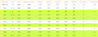

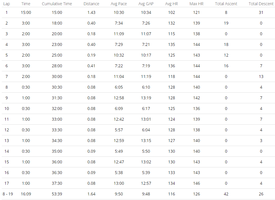

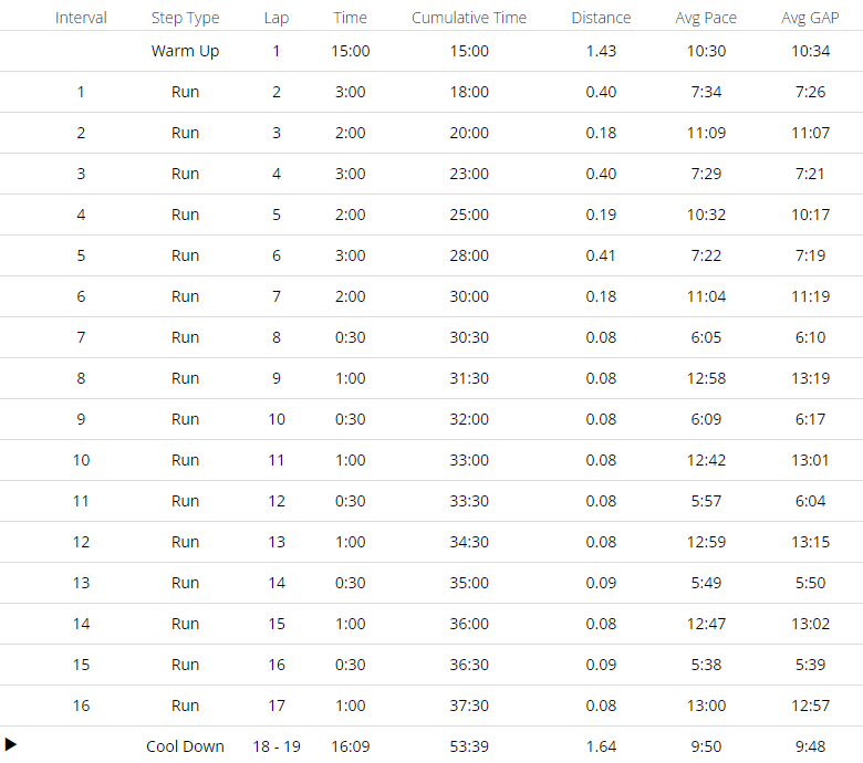

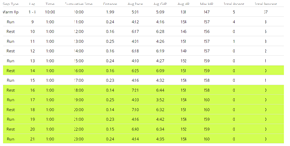

  • To be fair, my intervals were short, 30 s, but I would still expect to see faster GAP for uphill, and slower GAP for downhill (I'm not running down anything very steep).
    Even on the flat (highlighted rows) I get significant GAP variation, both faster and slower, although, again, for only 60 s intervals:
    For longer intervals, the GAP seems better.  The next table highlights the rows that have GAP adjusted in an unexpected direction, but, those intervals are either 1 minute or 2 minutes:
