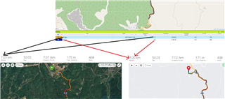

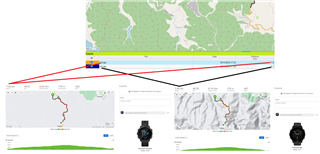

  • And so. The problem is still here after the update (17.24). below two links 1) regular route. 2) part of the regular route where the gps was broken.
    1) https://connect.garmin.com/modern/activity/12992591767
    2) https://connect.garmin.com/modern/activity/12992704962
    Thees two runs were recorded one after the other. You can see check it by start/finish rime. The situation is that the problem occurs only in the first lesson running in the first 1-2km. The next session is recorded fine. This was the case with firmware 12.XX. It is the same now with 17.24.
    I will try to install 17.26 and hope that something will change....
    By the way, this problem applies only to the running activity. Biking, walking are recorded perfectly!

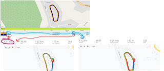

  • still have problems with gps. FW17.26. signs are the same as before.
    Settings:
    all+multiband
    recording - every second
    3d off
    Waited about 10 minutes before starting the run, hoping the satellites would lock on. Note: the green ring appears almost immediately.
    The problem occurs in the first minutes of the run and then everything becomes perfect.
    https://connect.garmin.com/modern/activity/13039346788

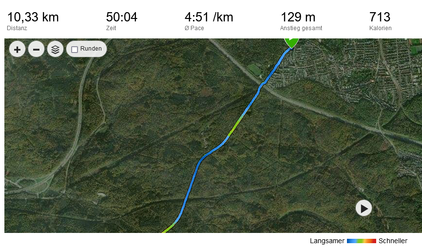

    My yesterdays run, I usually only wait 10 sec or so after the GPS lock (green ring), then start running and recording. On my common track it recorded 10,33 km yesterday, 0,01 more than the average result.
    Settings: Activity Run, GPS Autoselect/SatIQ, Recording Smart, all 3D off
