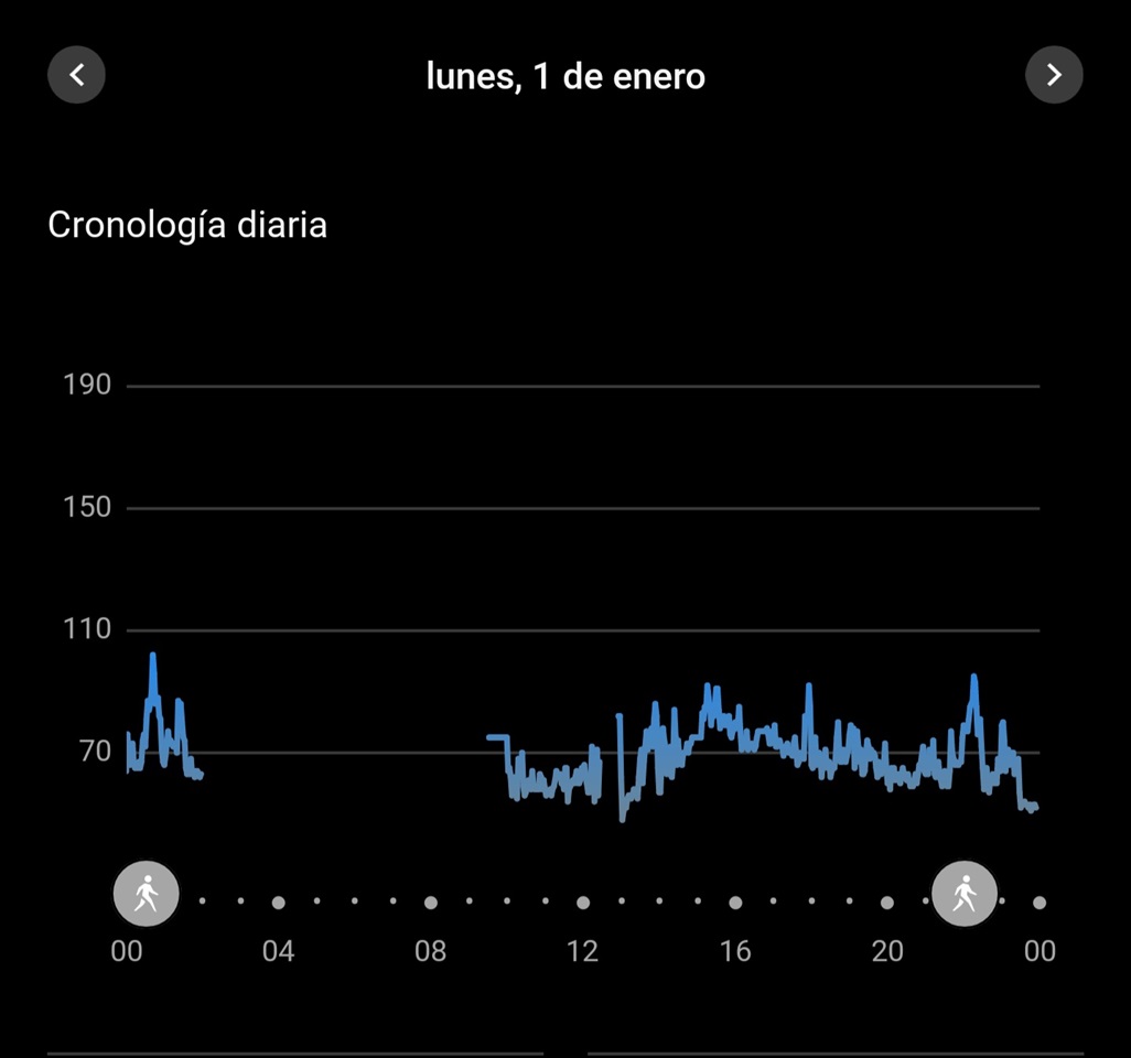

For about two Weeks I noticed my Forerunner 955 simply stopped measuring HRV in the second half of the night continuously. There sometimes are small measurements and sometimes none at all. I mainly noticed it because my overall HRV Score went way down, as the higher values from the end of the night were missing. I know the HRV Measurements aren't the most accurate to begin with so I usually use them as a very rough guideline, but the score also affects other metrics like training readiness and the suggested workouts. As a result the bad readings are breaking some of my most used features. At first I thought it was because I was wearing the Watch too loosely on my wrist and the sensor didn't make contact, but even with a tighter strap setting the Problem remains. Rebooting the Watch also does not seem to make a difference. I have been on Sofware version 16.17 pretty much since its release, so the problem probably does not come from an update.

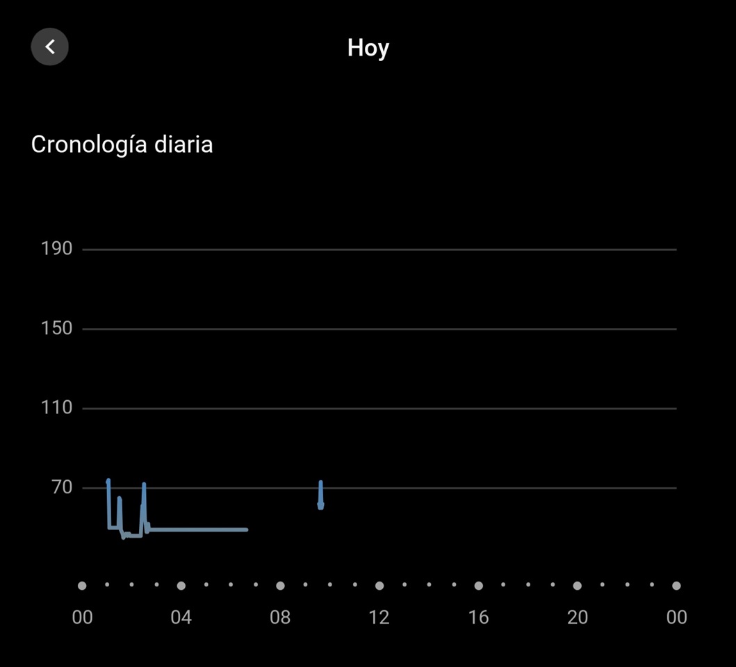

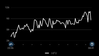

Below are the measured Curves where you really see the problem. 1 is a typical reading in the past weeks, 2 is a very extreme case and 3 is a normal reading from before this started. I don't think the Hardware suddenly stopped working, as everything else about the HR Sensor seems to work normally. The bad measurements have persisted long enough now to make me think there is something wrong with either the HRV Measuring itself or the watch thinks I am already awake after 2 AM, as I have had two or three weird sleep measurements as well. Either way both would appear to be software based, so I am wondering of anyone else has experienced this behaviour.

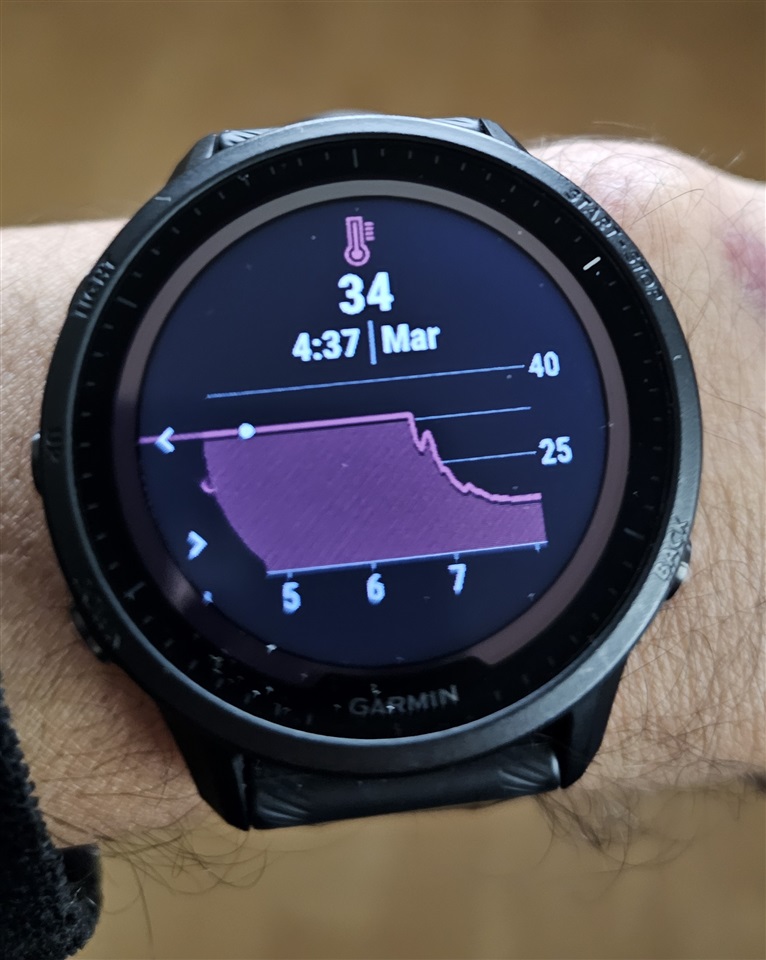

  • Here is the summary of my last 2 nights, again the heart sensor stops working. This morning, when I woke up and saw that it was not measuring, I looked at the temperature, saw the "sensor hub 0.0.1" again, and took off my watch. A couple of minutes later the heart sensor was working again and I could read "sensor hub 27.18"
    I did a test a moment ago, I left my Garmin behind the window in direct sunlight; as soon as the temperature has risen after 10 minutes, the sensor has stopped working again and "sensor hub 0.0.1" was again there.
    I still think that the problem is that as soon as the temperature rises a little (35 degrees is well below the limits set by Garmin) the sensor starts to give problems.

  • Interesting. I also looked at the temperature graphs and my watch also regularly hits 35° or 36° during the night. But my pulse readings are not affected at all. They don't have gaps on the watch or in connect. But maybe if the watch got even hotter that would also happen to me. I guess I'll try the same setup you had, when it gets sunny here again.
