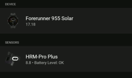

  • Look into the log of an activity (on an app or the web). Near the bottom will be a list of sensors used and their software versions.
  • For example, in the Android app, in the log for today's run:
  • Thank you very much for taking the time to respond. Yes, this I know, in fact I see Software version 4.1 for the speed sensor and 2.5 for the Dual HRM. But for example the cadence sensor is never listed in my cycling activities and the sensor works correctly sending the data for each activity.
