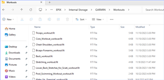

  • Might be easier to delete the workouts from the watch while connected to a computer.
    The workouts should be located in the folder \Forerunner955\Internal Storage\GARMIN\Workouts
  • You are my hero! I was desperate! Thank you so much
