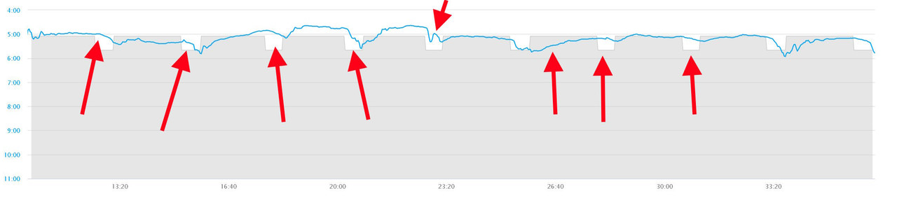

  • In my case I run interval training with (for example) 400m fast 100m rest and ... in those 100m of rest the FR955 is not able to track down my slowing  down pace.
    The resulting chart is totally wrong and unusable. Looking at the picture down below, in the real world I almost followed the gray chart, so when fast section ends I sharply slow down my pace. This is not charted.

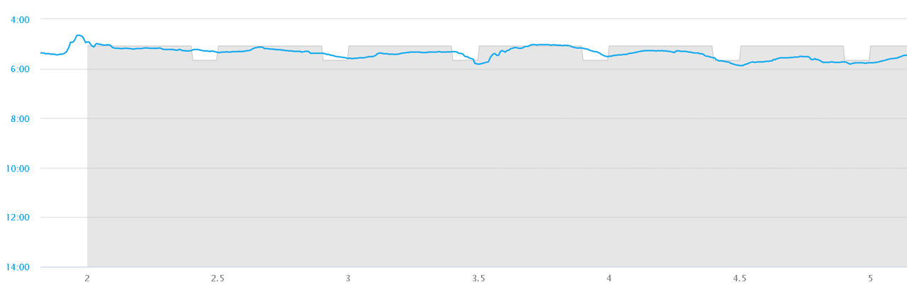

  • Well, this is the last time I did intervals.
    Setting Autoselect/SatIQ for running activity. Forerunner 955, FW 16.17 and HRM Pro.
    I did timed intervals of around 2 min and slow running pauses of around 1 min. The drastic change of pace is clearly and quite instantly visible.
  • That's a beautiful chart, we should consider that your variation are much wider.You're moving between 3:30 and 6.
    Same FW version and settings on my FR955, I'm missing the HRM Pro chest strap though.
    Sky in view, almost no trees.
    During my activities I play mp3s over bluetooth headphones, I don't know if this drain some computational capacity.
    I can't identify a clear reason for this.
    Sure, but also the smaller pace changes are drawn quite nicely.
    OK, it was out in the fields with no trees and quite flat.
    Very strange, I agree.
  • I don't consider slowing down from 5:00 to 5:40 pace as 'sharp' slowing down. Garmin 955 clearly does smoothing of GPS pace, and it take 10-15s for small pace changes to be reflected on the watch. It has some algorithm to detect large changes in pace though, and the smoothing doesn't kick in then.
