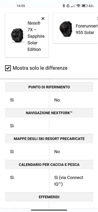

- esiste la prossima forcella sul forerunner 955? Quando usi il comparatore sul sito ufficiale Garmin, ti sembra di capire che il 955 non ha questa funzione.
Next Fork is supposed to work even if you're not following a route. It's a data field.
And... it does seem to be available in the current 16.17 software. I've just added it to the Hike activity…
I can confirm that the Next Fork field works on the 955 even if you have no route. It displays either two dashes, or a distance and the name of the next street, path, or road that you will cross. There…
It's features like this that Garmin use to differentiate their Outdoor series of watches from their Sports/Fitness watches.
It might appear on the FR series in the future as it's purely a software thing, and the software teams seem to be moving closer together (eg. endurance/hill scoring which came in with version 16, but had been a feature on the Outdoor series for a year or so), but I couldn't guess if or when it will appear.
