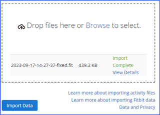

I always upload to Garmin Connect Web to test before posting here. This is what I got...
Are you sure you uploaded the correct file? 2023-09-17-14-27-37-fixed.fit
I tested again. No strange 1500 km gps…
I tested again. No strange 1500 km gps tracks.
