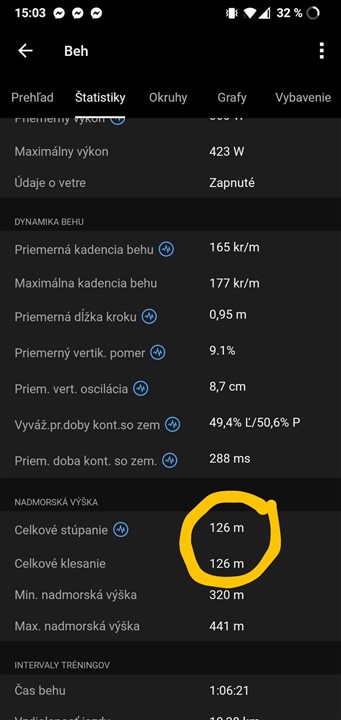

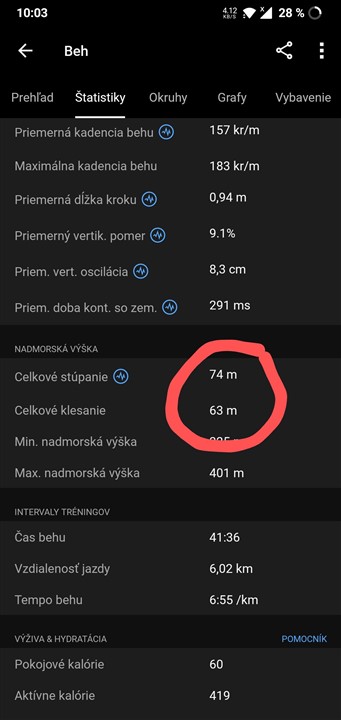

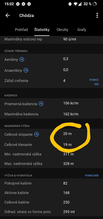

  • The watch arrived yesterday after being replaced by the service center. And you can immediately see the differences in the height readings. In watch mode, it is stable, there are no strange drops or rises. During training it was also very good, in the old one I had over 120 m on a known route, on the new watch it was 16 m (correct). To sum up... these are the values I had a year ago after buying the watch. So the one I sent for service must have broken down.
