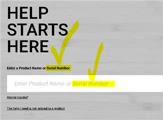

    Ps. Regarding the screen you provided. I checked couple of days ago, it identifies the model from both serial and this id - both showing 955
