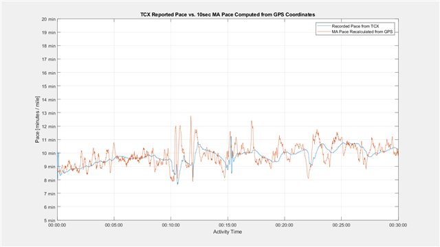

    I guess that a silver lining is that I got to put together a fun little TCX / FIT analysis script so I can play around with the recorded data when I want to now. Here are some findings from two runs on the exact same path, but a couple of weeks apart and without/with the HRM Pro strap.
    This run was with no strap / FR955 doing all of the pace calculation per its built-in functionality.
    Blue line is the pace reported in the TCX (trackpoint > extensions > ns3_TPX > Speed) and presumably what is shown on the watch face.
    Orange line is recomputed directly from the GPS data (total recomputed distance is within 1% of the recorded total). Since the raw GPS-pace values are really noisy, I applied a 10 second moving average window to it to make the plot legible.
    The two series track well, and their mean pace values are within 7 seconds of one another. The mean of the blue pace series is 9 seconds slower than the average value reported in connect (which should always be correct as it is [total moving time / total distance]), and the mean of the orange line is 2 seconds slower.
