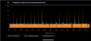

After the 15.19 update, it seems like the stroke rate for rowing activities broke. There are frequent high values close to 150 strokes per minute. The activity shown below was actually at 20 strokes per minute.
In case someone at Garmin is looking at this, it would also be of great help, if the pace scaling would be adjusted to meaningful values. These could be in an interval of 4:00 to 0:30 (minutes:seconds per 500m). What is currently being shown is totally useless because of a max at 30:30 (possibly while drifting or pausing). All relevant and interesting data points get drawn as an almost horizontal line.

  • +1, experiencing pretty much the exact same issues on my 255. In my recollection the spikes have always been there to some extent, but they seem to have gotten worse with the recent update.At first I thought they were due to the lap vibration alert interfering with stroke count somehow, turns out not to be the case.

  • In my case this was on the water, not a Concept2 rower. So stroke rate is only measured on the Garmin watch - which it seems to be doing well, except for those spikes occurring at the lap starts/ends.

  • No, it's on water. This even occurs at very smooth water (no wind) and close to perfect rowing movement. I had this problem in each of approx. 15 activities since the update and never before. I would assume this to have something to do with the new accelerometer code for wrist powered running dynamics . Maybe some variable is overflowing or so. I contacted the support team and they had me upload my Garmin folder in order to create a software support ticket. I would reccomend you to do so as well. The forum gets much less attention compared to official support requests.

  • I have probably the same problem on Fenix 7 during open water swim.
    Stroke count spike appears every 100m, which is every auto-lap which I have set to 100m.
    As I have vibration alarm on, I presumed it is due to stroke counter interfering with vibrations indicating lap.
