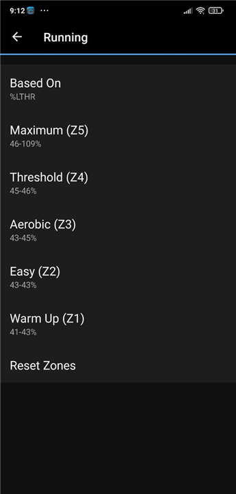

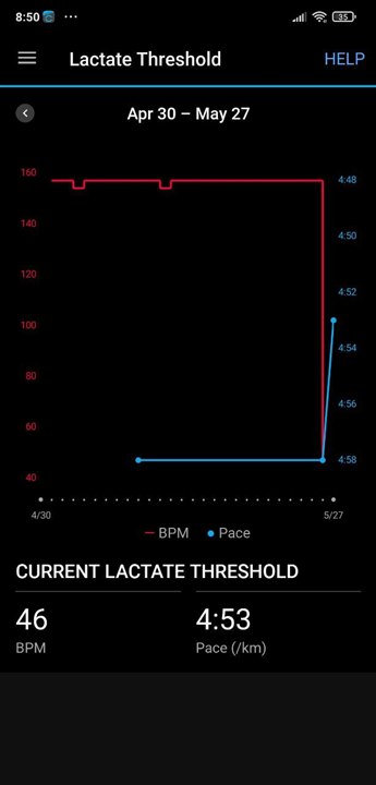

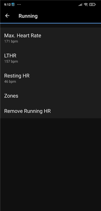

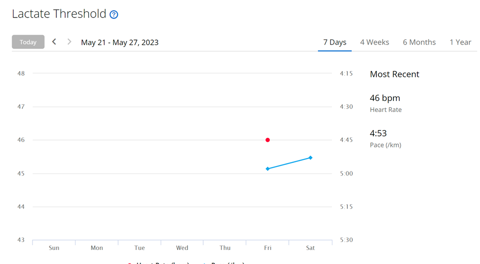

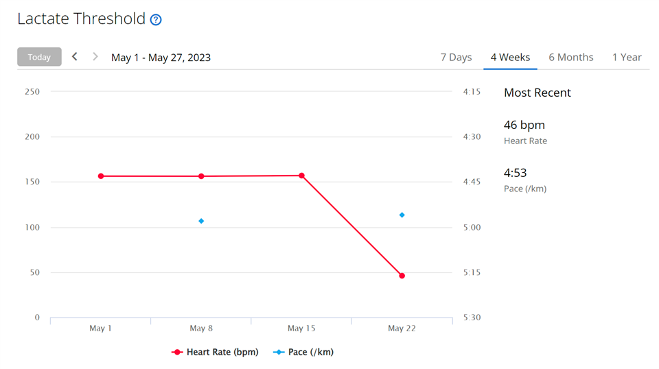

  • Yeah can confirm this is happening. I've I modified the lactate threshold manually (46), reset my HR zones and did a guided LTH test. Shows up on my watch but not on garmin connect.
    Synced with garmin express and phone app. FW 15.19
    Also, the Running HR Zone based off LTH did get modified to 157, but the HR Zones themselves didn't.
