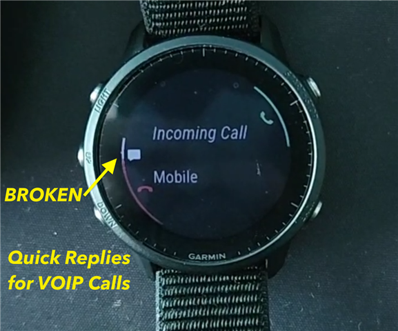

  • Hi
    It is correct it is a "feature" and not a bug.
    The reason is not related to how the Garmin Watch or the Connect app  works - but how WhatsApp shows a Notification on Android phones. On an iPhone a Notification for at call is a one-line-message split into two lines automatically.
    On Android phones it depends of the phone vendors UI. WhatsApp have "hardcoded" phone model numbers/Android OS to send the notifications to a locked/unlocked screen and sometimes that could be with a special character for that specific UI that Connect does not know about.
    A solution can be made i the Android Connect app (to remove all characters in a specific range - but the result could be more display errors on the watch).
    The proper solution would be that the Vendor of the UI on notifications follow standard notification rules (which WhatsApp does not).
    If you have more example then bring them on.
  • This happens with all calls other than cell. It's not specific to WhatsApp.
    Another example is already quoted above. Are you a Garmin employee?
  • No, I am not an garmin employee!
    If the same happens with other apps that are not normal calls (it could be Skype, Teams etc) - the reason is still how the Vendor of the UI adds notifications.
    The Main problem is number of charactors. Lets say that your display is 40 characters wide and the notification is 52. The Notification then needs to be spilt into two lines. The OS itselv will do a hard spilt 40 characters in line one and 12 in line two. The problem with that is words will be split wrongly.
    Example:
    "It is hard to be a developer in this amazing world" will be split into two lines:
    1) It is hard to be a developer in this ama
    2) zing world
    So as a Developer I would change the notification in code to
    2) amazing world
    If it is done wrongly it is actually two notifications and not one - and that raises the problem.
    (I have been struggling with exact same problem when I worked as a developer at Microsoft).
  • The notification is not divided. There are 2 separate individual notifications.
    The empty one obscures the one that's not empty.
    P.S. I'm a computer engineer as well.
  • here's a short clip hope you can diagnose. Quick replies are also broken.
    need your help.
