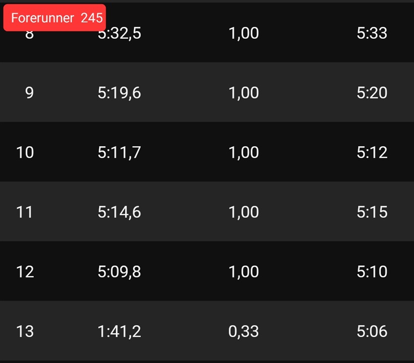

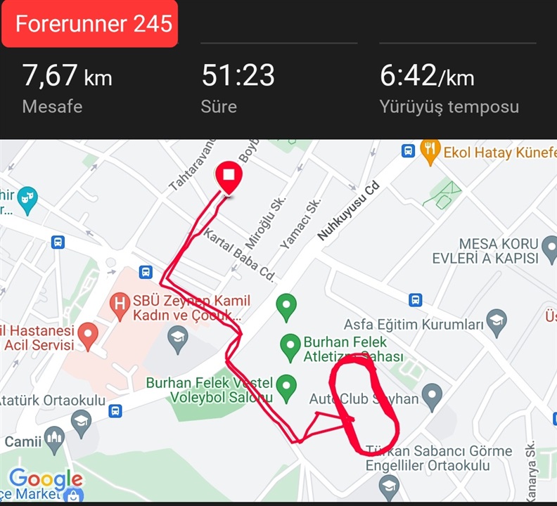

There has been a problem with the GPS tracking of the watch for the last 3 days. Although my wife and I run side by side at the same speed for the same time, there is a serious difference in speed and distance. Look at the difference between our run this morning and 955 and 245.

    245 more accurate.

  • Does the route you followed have a lot of sharp turns? Does it have a lot of buildings or trees?
    Have you compared the two GPS traces to see whether one of them is cutting corners or going off track?
    In general, I find the 955 is very accurate, far more accurate than my previous vivoactive3. For instance, my local four-lap parkrun course has many 90° turns in a short distance and lots of tree shade. My old watch sometimes measured it as short as 4.2km, but never 5km exactly. The 955 always measures it as being over 5.2km!
