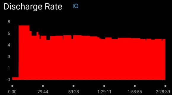

  • Got back from biking. Wasn't sure if I will end up somewhere in the forest so I used Auto Select (All systems or GPS would also be fine)...so 19% in 2:30 (in fact 3:37 total with pauses) + battery drain after the activity (turned off sensors and put it in the airplane mode...activity not synced then). Had to do a "long press".
    Must try All systems AND GPS only next time and without sensors and no pauses.
    I am not sure why it had quite enough time with over 7% and then it stabilized at about 5,5%.
