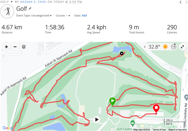

Noticed that my FR955 golf walking distance / odometer was reporting less distance walked than my FR935 and VA3 used to.

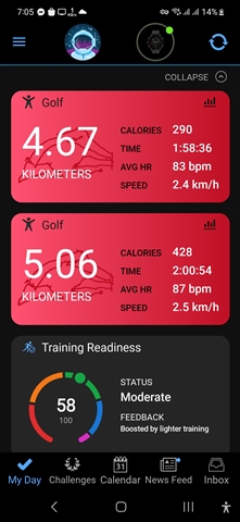

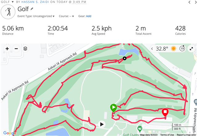

Today I wore both, FR955 and my VA3, on each arm, and ended up with 2 activities for the same round of Golf. Above FR955 Below VA3.
I noticed another quirk which both watches exhibit. The distance summary shown at the end of the activity before saving is approximately 6-7% higher than what gets saved:
Before saving the activity on VA3 the distance is 5.32 KM
The distance which got saved and uploaded to Connect is 5.06KM instead of 5.32 KM
Likewise for FR955:
Before saving the activity, the distance on FR955 is 5.03 KM
The distance which got saved and uploaded to connect is 4.67 KM instead of 5.03 KM
Can anybody make any sense out of these 4 different distances recorded for the same golf round? During the round both watches matched the yardages and auto-shot distance almost exactly.
Even the maps look exactly the same:
If anyone can shed light on which is the correct distance figure out of 4.67KM, 5.03KM, 5.06KM, and 5.32KM?, it will be a great help to me.
