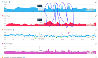

30/03/23: 5k race done at maximum effort. Typically for these my heart rate will site high 170bpm. Referring to the below image, the watch had my at 140bpm for the first 12 or so minutes before jumping and correcting itself to around 180bpm for the rest of the race.

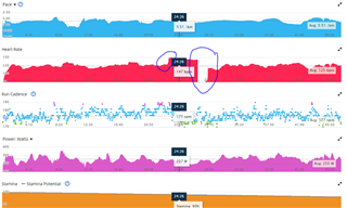

30/03/23: On the warm up for the above race, the watch threw my heart rate up to 140bpm at the start (would be lucky to be over 100bpm at this point) and plateaued around that number. I did a couple of strides (as well as other drills) during this warm up which usually always picks up my heart rate. See below graphs compared to an equivalent run done the day before which contained strides.
Equivalent workout from the day before:
