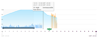

This leads to some weird looking graphs. Below is the body battery graph from GC web with the sleep and activity times overlaid. The location of the vertical line is where the activity start should be.
On GC mobile the offset is even worse. Because the activity on GC mobile was recorded an hour later, the offset on the graph is actually 2 hours, not 1 as is the case with GC web.
