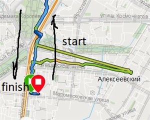

Six months have passed, and the problem has remained in its place. The same scenario. The first 4-6 minutes watch does not catch satellites. More precisely, they show that they catch, but they don’t. Below are examples of what is happening. No, these are NOT jammers. I’m waiting 4-6 minutes before my run. Buildings are no obstacle to the watch - running with friends on the same route proves it. Running in the opposite direction this place my watch records the perfect track. Starting in different locations gives the same results. At the same time - if you turn on the watch, catch satellites, but do not start the training and run for about 5 minutes, and then turn on, the exercise will record normally! It started from FW 12.23!!! In September last year!!!

https://connect.garmin.com/modern/activity/10632861838
https://connect.garmin.com/modern/activity/10592270404
https://connect.garmin.com/modern/activity/10626142610
https://connect.garmin.com/modern/activity/10612130897 - start with delay – check it. NO jams.
