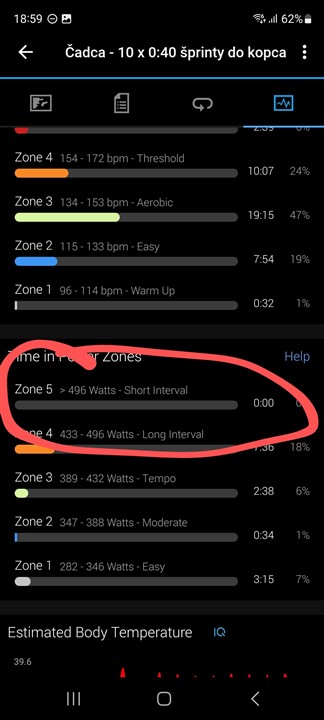

[14.xx] BUG. Does not show power in zone 5
I looked at the history of the runs and found that the software with version 14.xx does not show the power times in the 5 zone in the tables. It is the same in watches.

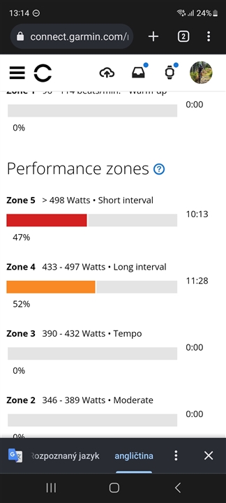

  • Today I ran 5k in a high heart rate and to my amazement the power showed up in the 5 zone.
      zone 6 did not appear.
  • I managed to get rid of the Z6 problem in GC web by resetting the power zones on my watch and setting them back again. Haven't yet done a workout since that involves power readings in Z5, I'll post an update once that happens with the results.
    Update 3/6: Did an interval workout with plenty of samples in Z5. This time the watch correctly recorded the amount of time spent in Z5. So resetting my power zones seems to have fixed whatever problem was there before.
  • For me, the last runs normally show the time spent in zone 5 and zone 6 is no longer displayed on the web. I feel like Garmin fixed this somehow without updating the watch software.
