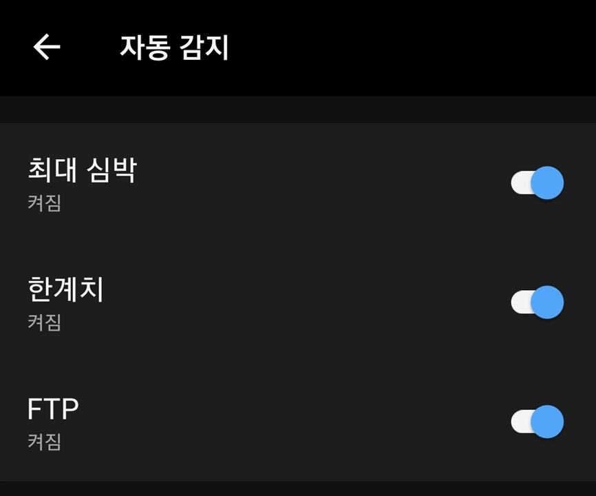

Auto cycling FTP detection was not working. Fw 14.15
I am using my new FR955 since one month ago, my cycling FTP was not detected once.
I did on auto detection on setup, three kinds of options all.
And I weared chest HR sensor and rided 4h over.
What is wrong?
