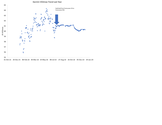

    Confirms that Garmin is broken - the VO2 max from the .fit file is stuck at 60, Runalyze can vary 10 units different.
  • Confirms that Garmin is broken - the VO2 max from the .fit file is stuck at 60, Runalyze can vary 10 units different.

  • Well I'm not sure what kind of average Garmin is calculating and over what time period. My VO2 max has been (from the .fit files) in the range 60-61 and seems immovable from the day I switched from my Forerunner 35 to 955 in July last year. This has included blocks of de-training for 4-6 weeks because of injury, significant training blocks where fitness has returned. They are so far out of sync in terms of variance and rolling average, something is broken.
    That does sound like something is broken for sure. If you detrain I'd expect your VO2 Max to drop 2-5 points.
