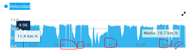

Hi, my Solar 955 FR is doing 0 km/h during the activity but that`s wrong because I`m not stoping. You can see below:
This is a screenshot from my last activity yezterday.

    The map is not messed up when the speed is going to zero, my activity is kayaking but the way looks as usual.
