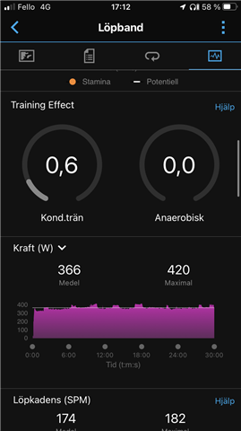

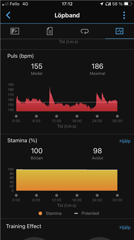

  •    Are you of the opinion these stats seem legit? This is from a steady pace 30 minute run normally in zone 2 and 3.
    I used HRM-Pro during this run. That f-cked things up.

    Please point me in the right direction, I have the problems with the Pro-strap (always) and the runpod (when having anything else connected via BT). I do NOT have problems when using Polar verity sense, which points to the internal Garmin communication via ANT+ as the problem. You can see how it messes up the stats on the pics I've posted earlier.
